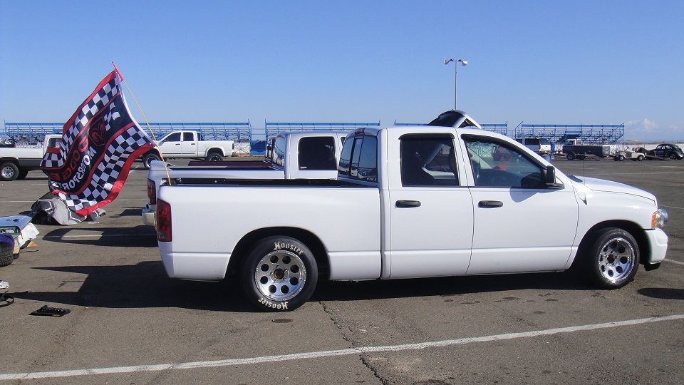

These are MT 295/45-17. Given it's a 4x4 they clear everything nice. My yellow truck is lowered 2/4 and i put 285/40-17 Nt555 on the back of it and they aren't too wide for the fender wells either.
Save
#5 ·
Here's a pic with all four on. Haven't been to the track with these yet though. These should cure my traction issues at the track haha.
you don't wanna go too short with your 4.56 gears plus boost though. A 29 or 30 inch slick or d/r would maybe be better. My MT's are labeled as 28 but they are shorter than that.

Those are factory SS/t dodge truck wheels on my red one. They're 9in wide wheel vs the offroad alloy wheels, which are 8in wide. I lucked up on the sst ones at a swap meet at Bristol this year haha. They offroad ones are easier to find though, and I love how they look as well. But any 17 would do I'd say. Idk how wide the steel ones are though, I think some of those might only be 7in wide but I'm not sure haha.

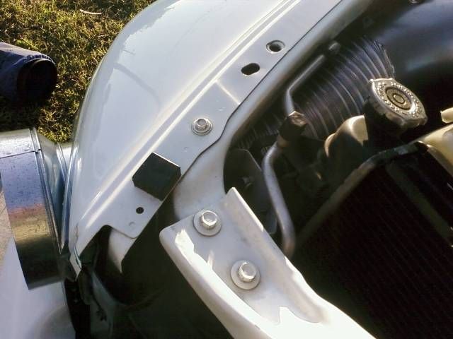

#20 ·
go to home depot or lowes and go to where all the ducting is.. it's like a reducer...
