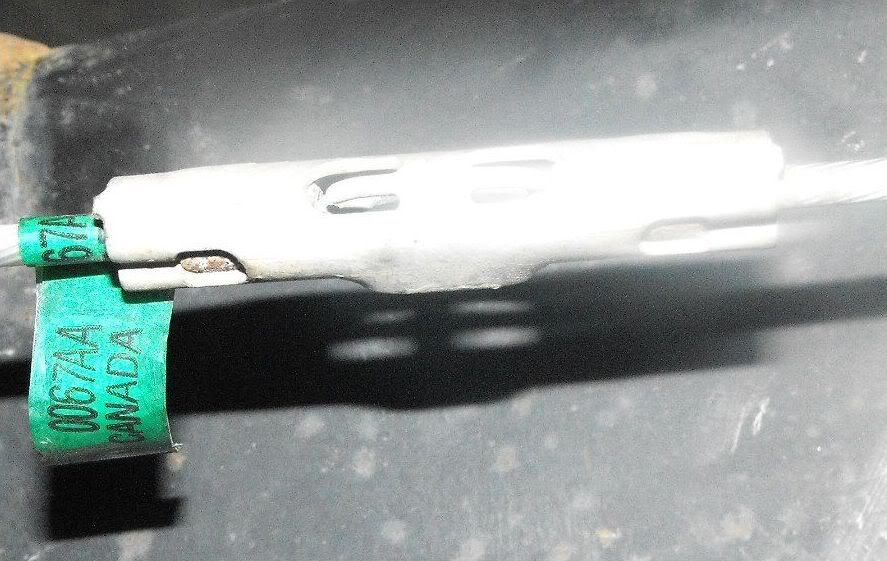

And where can I get one? FYI it's a connector for hooking 2 ends of parking brake cable together. No luck at the stealership, all they said they could order was the whole cable, and even then didn't know if this would come with. They just combined stores with the same owner's GM dealer :YUK: so I wasn't overly confident with the parts guy and the Mopar guy was gone for the day.

There's another one near the front of the truck. I had to cut it in half to get the cable apart while installing the body lift.
It's called a brake cable connector and you should be able to get it at your local auto parts store. Wagner/Raybestos/Bendix all offer that part in their catalogue.

Yes only one dealer. The same person owns GM and Chrysler stores which used to be 2 separate dealerships, but he moved everything to the GM store a few months ago to consolidate. I can't really say that I blame him, he is trying to keep everyone employed, and it's probably not the best time to be a car dealer in a town of 5000 people in this economy.
As for the connectors there's a little tab that holds the end of the cable in. But after 7 years of crud getting in there they didn't want to budge even after releasing that. And frankly I didn't want to make a 5 minute job an hour project when I thought I could just go get a new connector.

I don't suppose you'd have a part number? I struck out at the parts store and tried Raybestos and Bendix websites with no luck either. Couldn't find one for Wagner.

The green sticker has the last half of the part number for a parking brake extension cable (p/n 52010067AA)
I'll check the dealer locator tomorrow, see if I can find a dealer around me with it and ask if thats connected.

Eldon. Lloyd Belt is the dealer here. I guess I'll try salvage yards next week I hate to buy a whole cable for one little clip.

you couldnt get it unlatched? all i did was clamp the wire on the side closer to the gas tank to the frame, then used vise grips to pull the front. push the parking brake in all the way, it gives you more slack. just let it out gently
