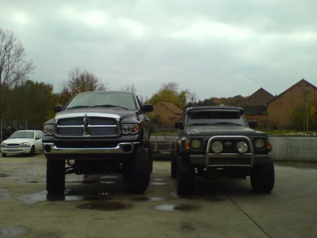

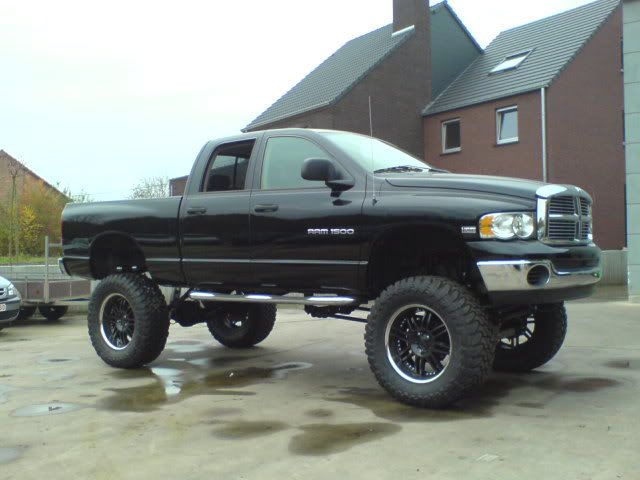

Hi, i have a dodge ram 1500 5.7hemi 4x4 '04 and i have done a 10inch suspension lift and 40/15.5R22 toyo tires. I want to know what gears i must put in the axles. I'm from belgium and i dont find a shop that have them on stock. I must order it from amerika and it will take a couple of weeks when i have them. So i must be sure that it is the right one i will order because its not possible to send them back or sell them. When i put the right gears in, will my dodge accelerate like he was stock? I want that he accelerate like before or a little less. Now he is a slow turtle.
Here are some pics of it.
Before:
After:
Next to my nissan patrol gr with 4inch suspension lift, 2inch bodylift and 33inch mickey thompsons. He looks so little :D
