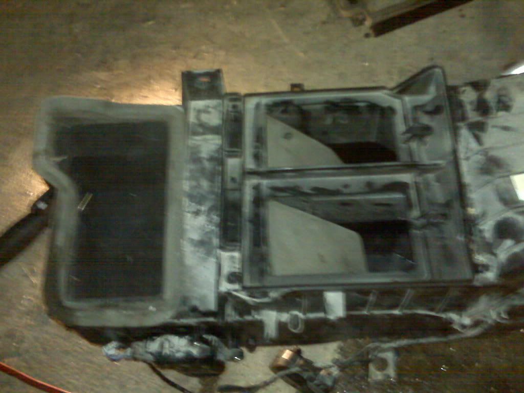

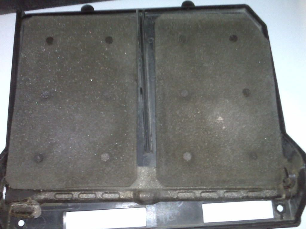

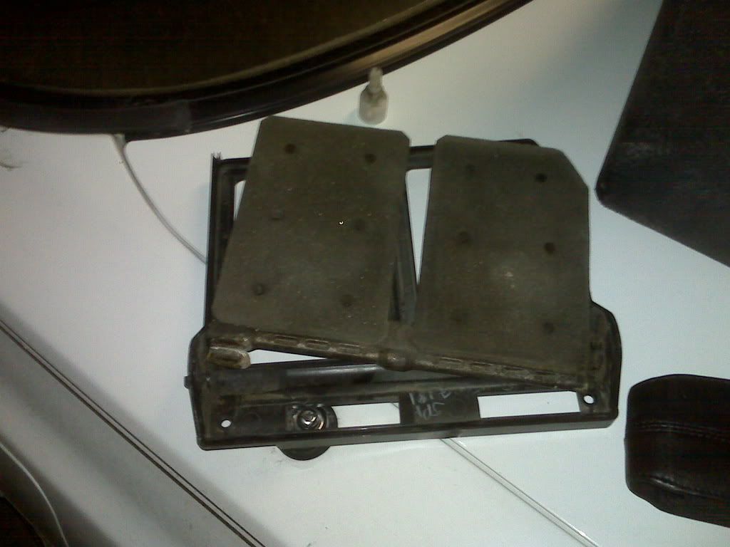

alright I did most of the dreaded HVAC blend door repair. I see why the dealerships charge so much. Anyways I replaced one door on the bottom05073964AA. I need to find out what the PN is on the top door of the HVAC system. It was broke as well. Anyone know?
154 Posts
I plan on asking the dealer, I just wanted to save some time so I can call with a PN. My experience in the past when you call a dealer and tell them what you need(w/o PN) hasnt worked so well. I figure I will take the thought process out of there job for them and tell them what I need if I have the PN.
154 Posts
If I was still at the school, I could have looked on alldata.
No part number stamped on the part?
no unfortunately not, that was the first thing I looked at. The part is injection molded, so no PN on it.

By reading the TSB it says all you have to do is remove the cluster and lower the steering column to fix it. But it also says it only takes 2.3 hours so who knows and what is the panel mode>
