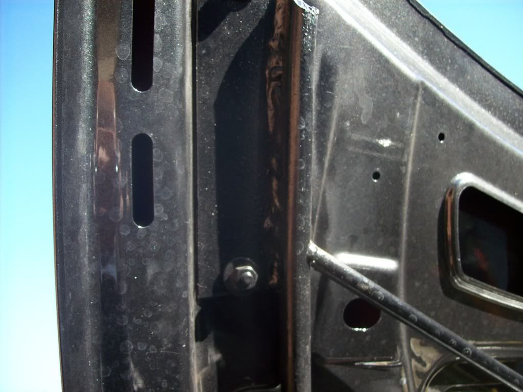

The underside of the hood is reinforced with a frame made of round bar.
The frame is then attached to the by four flat brackets, each with two bolts.
The frame and the flat brackets are welded together.

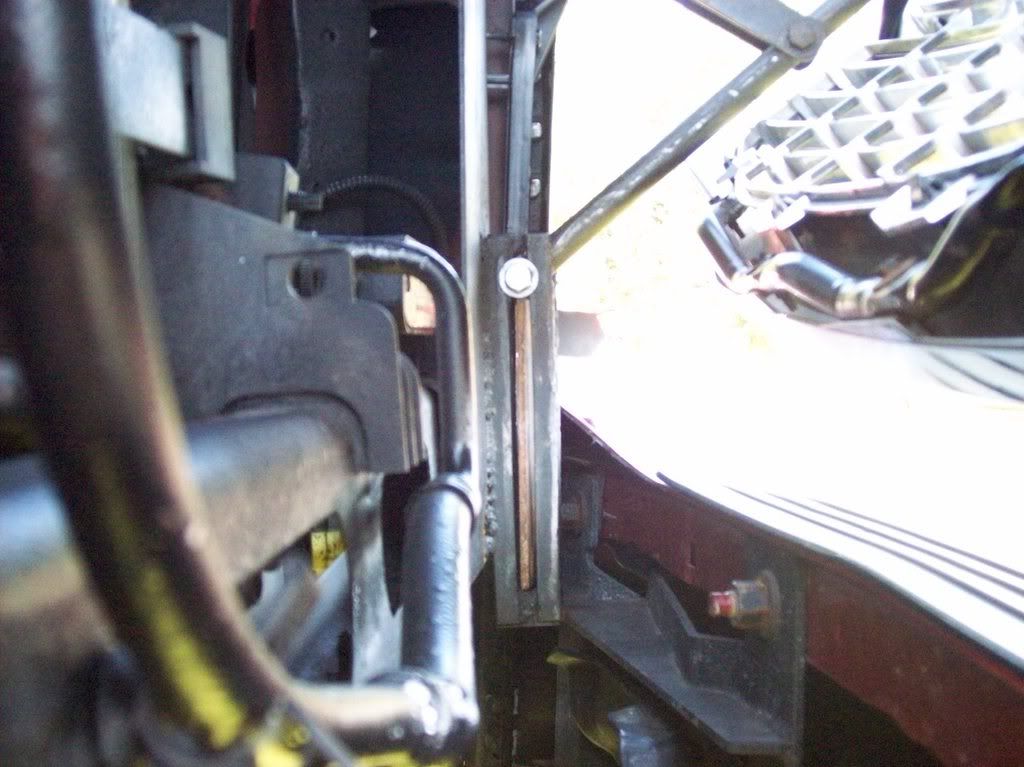

Then, both the left and right side of the round bar frame come into the engine compartment, and is secured into blace with a bolt.

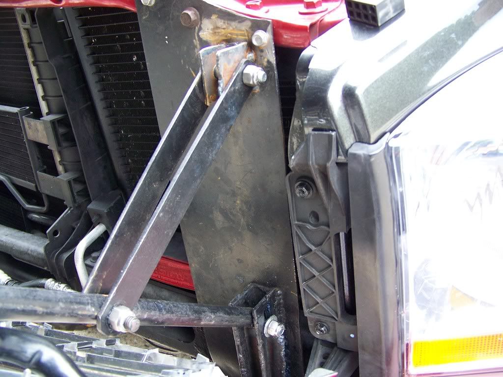

The mid-part of the round bar (both left and right hand side) are connected to a cantaliver system, and are held in place by a bolt. The other end is bolted into the body, on either side of the radiator.
To prop the hood, I simply have a piece of scrap under the round bar bolts, chocking them.
