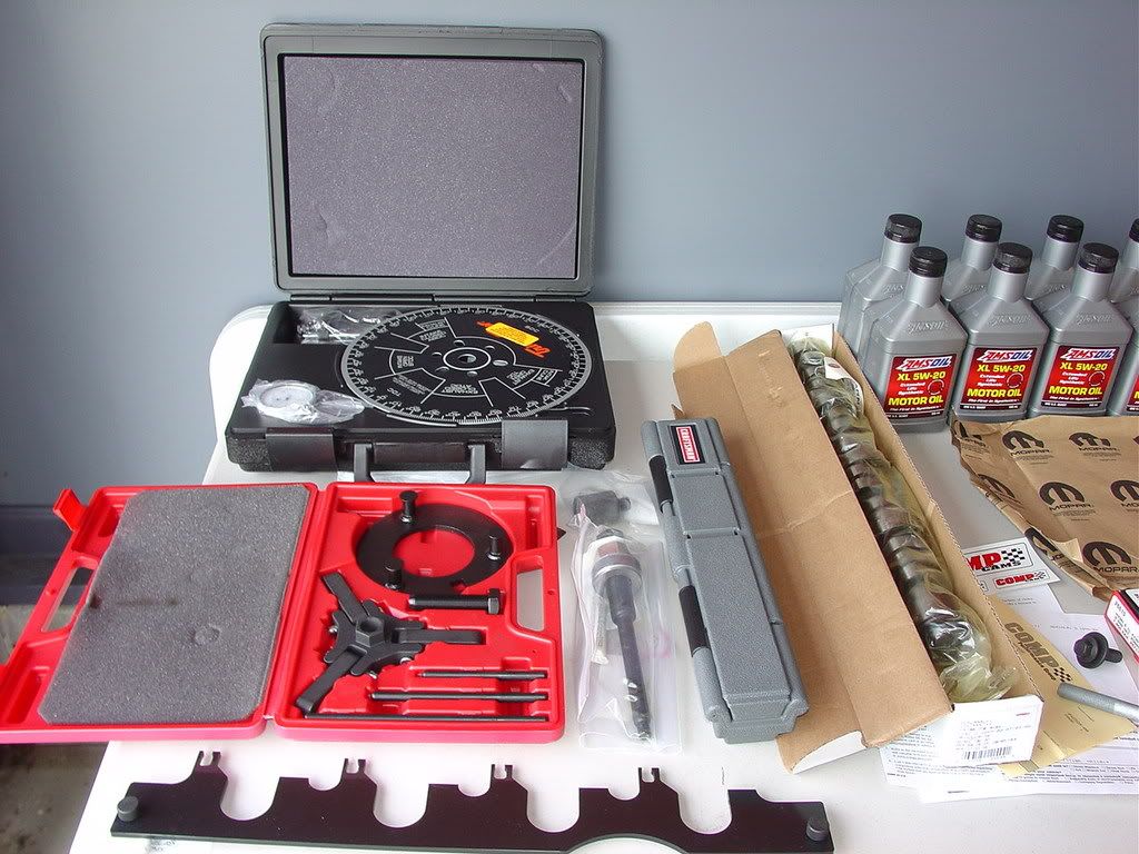

Today I drove the truck and it drove great, so I decided why not tear it up. For the last couple months I've been gathering all the pieces and parts needed for a heads and cam swap. With a lot of help from others and a lot of research, I think I've got just about everything I need. And now I have the time. I plan on taking my time and have the next two weeks off, so I'm in no rush.
Thanks to everyone that got me this far. Bob, Jerry, Denny, Matt, Chris, Sean, Gadier, Luke, Stu, Marty, too many to list.
I started to organize everything.
