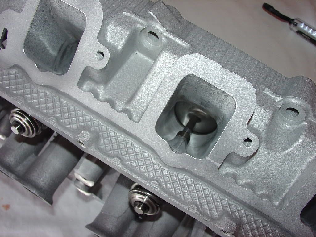

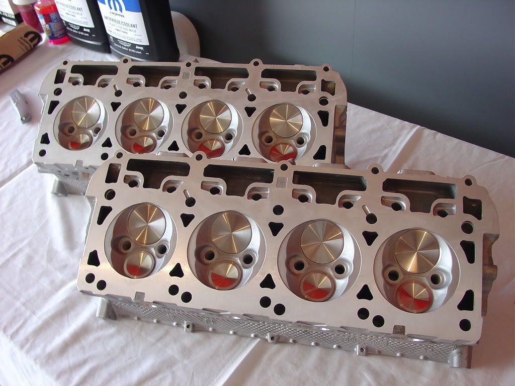

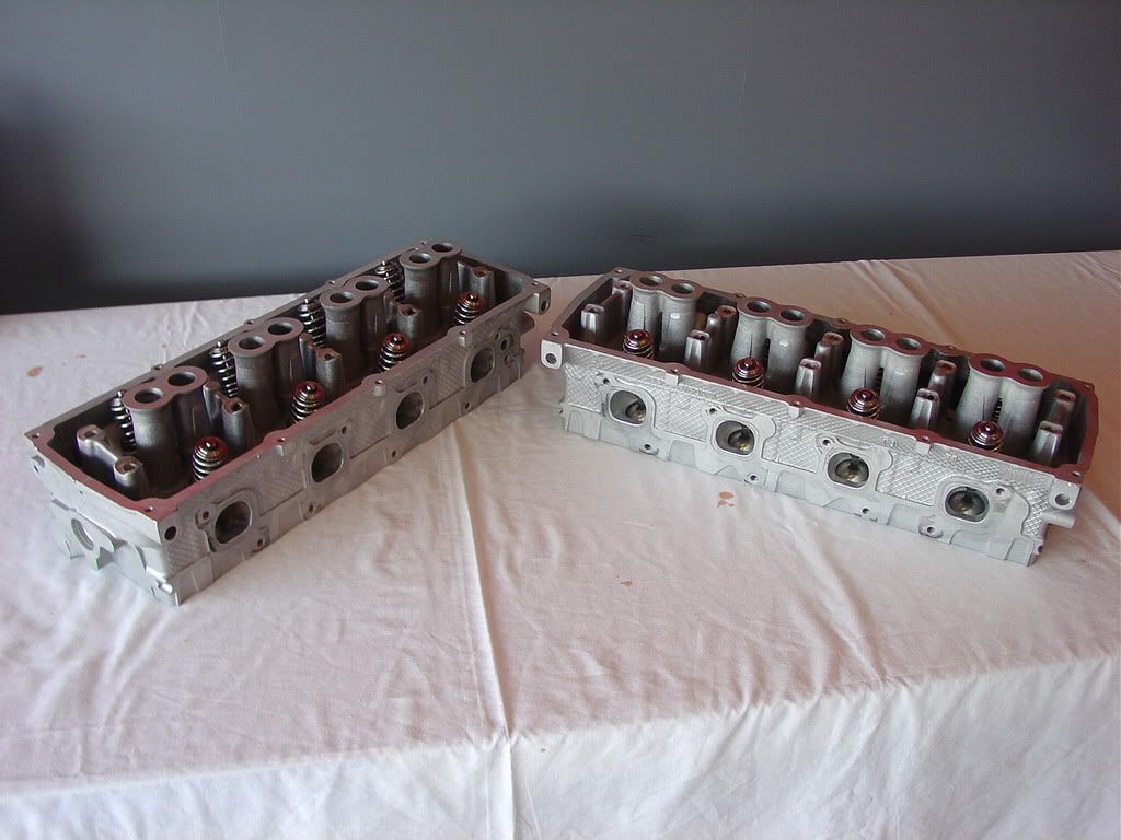

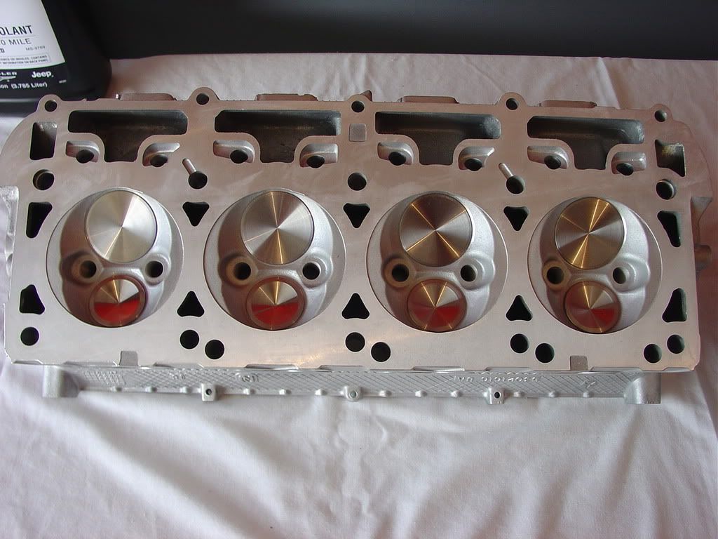

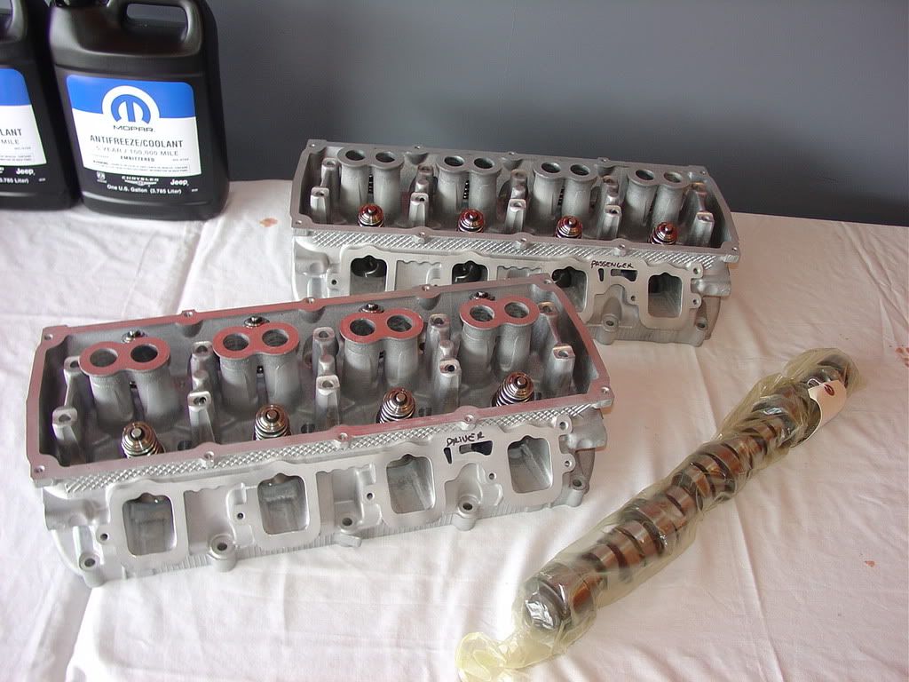

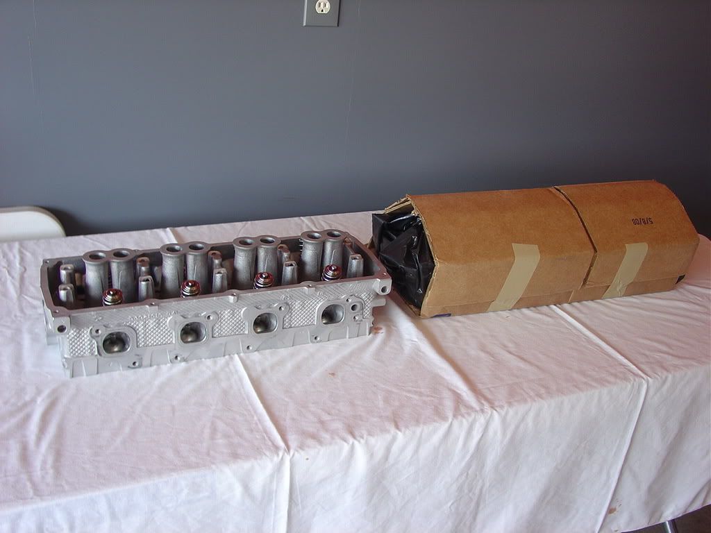

Just got these today! Sharadon 5.7L heads, CNC ported, decked 0.020", 2.05 intake, 1.60 exhaust, Manley springs and titanium retainers, D-shaped exhaust ports, did I miss anything?
Oh, that little bumpstick is a 210x. Thanks to all that have anwsered my many questions to get me this far.

i have a suggestion, package them back up and send them my way, i will install them and tell you how they perform.
or you can have all the fun and install them on your truck,
I like the first option better. lol
Good luck with the install

Something about New Heads that just does it for me. They look sweet, can't wait to hear the gains from that set up......

yup I see the 5.7 intake port configuration (hump)... and the 6.1 exhaust port config...nice...

..i like the valve spring/retainer positon that's better for our rocker arms..

So are those 6.1 heads? If not why the D ports?
Matt explained it already in the simple version. I.E. They flow better then the square port.
The other side of it is a long story. I'll touch on it.
Since the Hemi heads design was introduced (many, many yrs ago)it's been great on the intake and not so great on the exhaust. When you look at Intake to Exhaust CFM ratio. 70% or better exhaust to intake ratio has been a rule of thumb for as long as I can rememmber. The last place you want to remove material is on the short side. That just makes the port turbulant and flow less. So,,,you have to remove it else were. The D shape is proven and fit's nicely to the round header flange.(we first did it 3 yrs ago) Plus the fast moving air helps pull the intake charge in during valve overlap.
So for those that have round tube headers with the round flange. It's an option that doesn't cost anymore then the square port opening.
