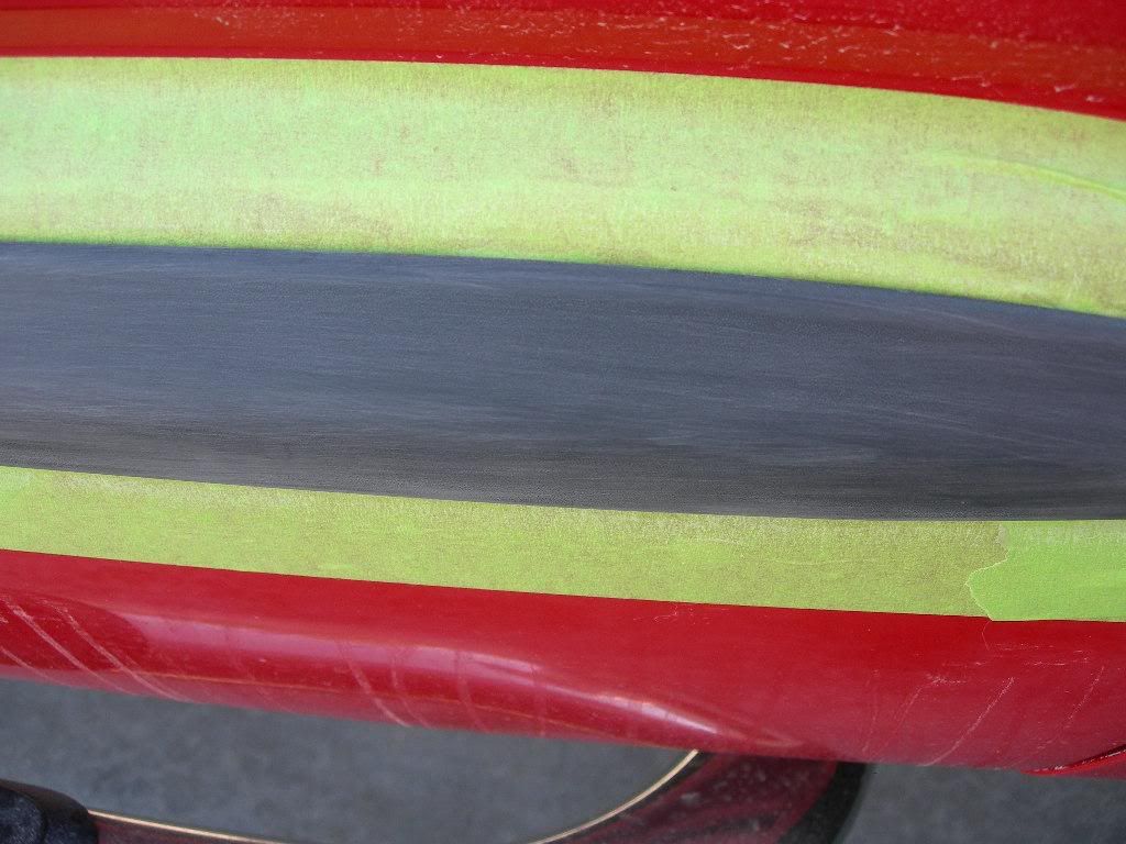

OK, so the first thing I did was get some green auto painting tape at the local auto parts store and put about a 2" border around the flares. The flares are not flush against the metal because they mount with a foam type tape. I tried to tuck the tape as far down behind the flares as possible.
I then cleaned them with the same soap/alcohol/was&grease remover that I used in the fender how-to and starting wet-sanding the texture (the tape protects the existing paint on the truck). I used 320 grit paper until they were smooth. I have since learned that 180 grit can be used as well and will get you there faster - just go over it again with some 320 to smooth it out a bit. Here is how mine looked after sanding them.
