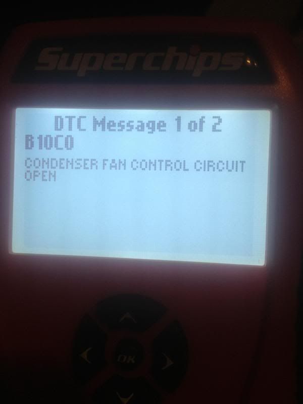

My AC does the thing were it blows cold while moving but warm at idle. I already know its the condenser fan, but I plugged in my Superchips and ran a diagnostics because I was bored, and this popped up. Is it just telling me that my fan motor is bad? Or something else which is making my fan not work?

Probably the motor. Pull the wire connector to fan. Check for power to confirm.

fuse to the condensor fan is much likely blown. This is often caused by the fan motor as stated previously. Check the fuses in your TIPM (In engine compartment). It is either 37 or 39 don't remember exactly.

I don't have anything to check the power to it...
And I just checked those fuses, they are fine. I was just hoping it was something more simple than replacing the whole thing. Guess I have to, it's starting to get hot here in the desert aha
