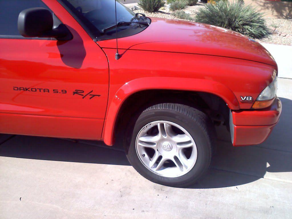

Okay so here is my How-to on how to change the front wheel hubs on dakotas. Everyone feel free to correct anything I missed because i want to post this in the Dakota How-to Forum
My truck is a 2000 Dakota r/t but this should be accurate for 97~2003 or so dakotas. As well as similar years of durangos
